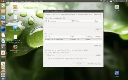

I recently downloaded the Lubuntu 12.04 LTS ISO for Power PC (I want to install it on an old iBook G4), but when I go to select the ISO in Startup Disk Creator, it just remains blank in the Source disc image (.iso) or CD: area.
Here is the screenshot from before (and it looks the same afterwards) selecting the ISO.
screenshot of startup disc creator
As you can see, the ISO is on the desktop separate from any other ISOs, IMGs, etc.

Yes, It is irritating that the .iso files are NOT being identified, certainly a bug.
Rename the .iso file to end with .img, and the usb-creator-gtk(startup disk creator) would identify it.
mv something.iso something.img

I found a "fix"
Startup Disk Creator looks in the Downloads directory by default. If finds any ISOs it sticks and will only let you use that ISO with the highest number and Ubuntu in its name. I solve this by moving ALL the ISOs from my Download directory in another directory. Startup Disck Creator can't default to any ISO so it comes up blank. It will then let you select ISO's from other directories as normal.
My exact process is:
1. Move all ISOs from ~/Downloads to ~/Downloads/ISOs
2. Run Startup Disk Creator, Source table will be blank
3. Click Other...
4. Open ISOs from any location as normal (in my case ~/Downloads/ISOs)
Hope this helps
This is only based on my computers running 12.04.4. Your mileage may differ.
