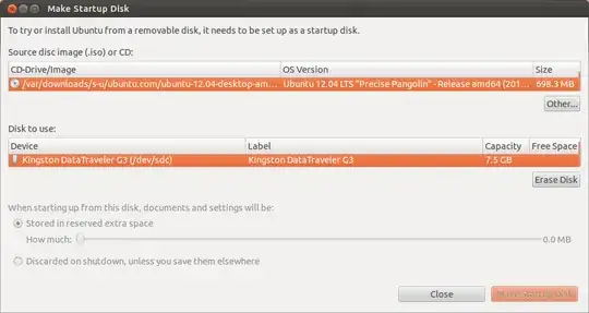

I downloaded the Ubuntu 12.04 LTS "Precise Pangolin" - Release amd64 (20120425).

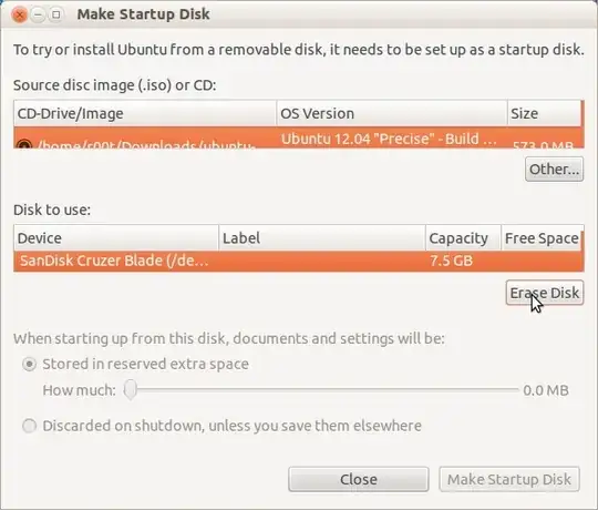

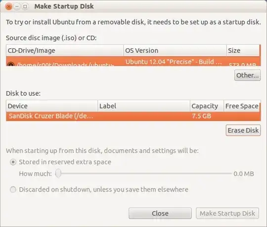

When I run Make Startup Disk, I selected the downloaded release. The drive shows up with a capacity of 7.5GB and a blank space under "Free Space". I have tried using the "Erase Disk" button, which seems to erase the disk.
The problem is that the options below the "Disk to use" section are grayed out. The "Make Startup Disk" is colored dull orange, while the source disc image and device to use are bright orange. The "Make Startup Disk" button doesn't do anything when I click it. The only working buttons are "Other...", "Erase Disk", and "Close".
Upon using Other button to select the ISO, it allows to select the ISO but it doesn't load and the "Source Disk Image" field remains empty.

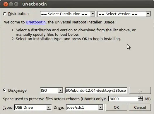

There is a alternative way to make StartUPdisk
You need to install UNetbootin. Go to software center and search for it. Then install....
Run it.....from application
You will see this window
  • Click on Diskimage.
  • Select iso.
  • Give 3 GB of space in Space used..... Then select your USB Drive from dropdown menu. Click ok. And wait until finished. Hope it helps.

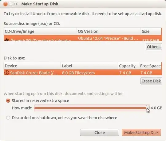

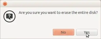

Free up your Pen-drive by using Erase Disk button. After finish, there will be an option to set the space that will be used on your pen-drive.
Open Startup Disk Creator
Select Pen-Drive and click Erase button
Click Yes when prompt
Put your password
Wait a lil bit and you will get an option to adjust the extra space.
If it still doesn't work, remove your Pen-Drive and reboot your system.
