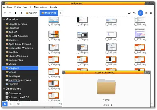

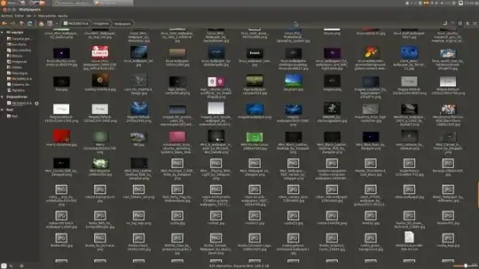

I have a problem with thumbnails on my Ubuntu 12.04 LTS 32-bit system with Cinnamon 2.0.14 DE and Nemo 2.08.
I have tried removing the ~/.thumbnails directory but it is not working for me. This is very weird because when I open an image in Eye of GNOME, Nemo is creating thumbnails but other images doesn't have preview thumbnails as one can see in my screenshots below. I have changed the preview settings as show miniatures always.
Screenshot 1:
directory full of images
Screenshot 2:
settings

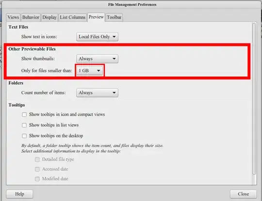

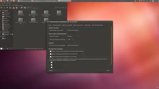

Nemo makes previews only for files less than one MB by default. You can change this from its preferences:
Screenshot

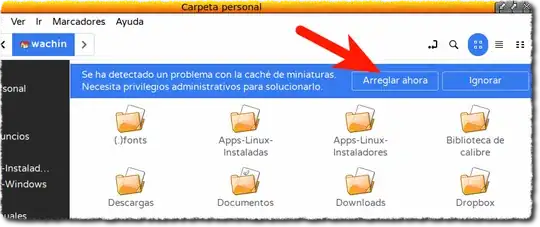

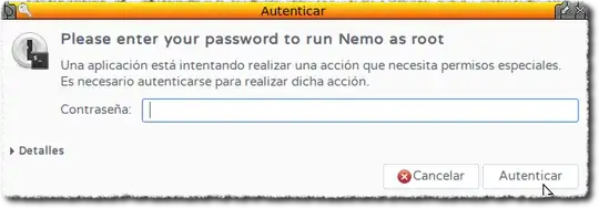

The solution for my in Xubuntu 18.04 x386 is to delete these folders by putting in a terminal:
rm -fr ~/.thumbnails
rm -fr ~/.cache/thumbnails
then open Nemo and he will say a message that there is a problem with the cache of the icons:
repair cache
now he asks me to put my password
set password
And see, working fine:
here
