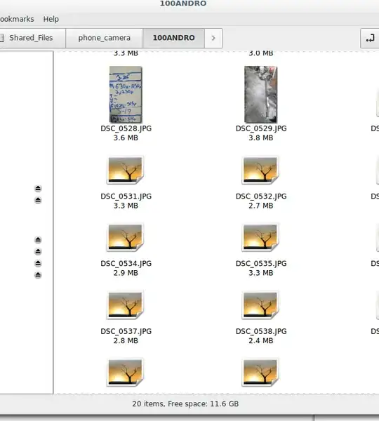

However, I've tried all of those solutions and still have this issue. Here's what I'm seeing: bad thumbnails

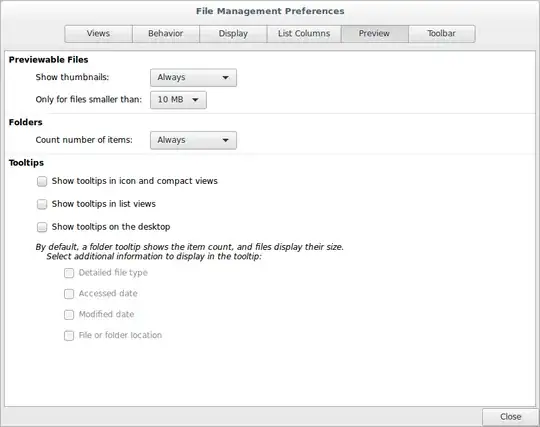

As you can see, i'm getting previews of images which are larger in size than the ones i'm not getting previews for. By the way, here's my settings for the size: enter image description here
