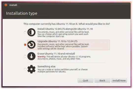

Just make a bootable USB or CD/DVD and boot it up as you would install ubuntu. When you are asked what you want to do just select "Upgrade...": Option

Okay, so since cdromupgrade file is missing or not available, the next best thing is to create a LiveUSB and go on from there. Since you're upgrading from 13.04 the entire process should be rather flawless.
  1. Open the Dash and open the *Create Startup Disk * option. This opens a window, from where you can choose the iso file and destination.
  2. Now select the 13.10 iso file and a usb (remember to use the erase disk option before you mount the image) and create your startup disk.
  3. Now, upon re-booting you should boot directly into the USB. Select the install Ubuntu 13.10 option.
  4. The installer window would present a number of options to you depending on the other OSes present in your hard drive.
  5. Choose the Upgrade to 13.10 option. This should get you going and ready for 13.10.
