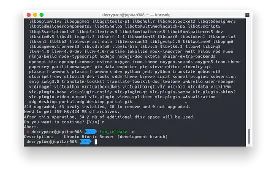

I got it using the Kubuntu-devel-release-upgrade command:
Development Release
