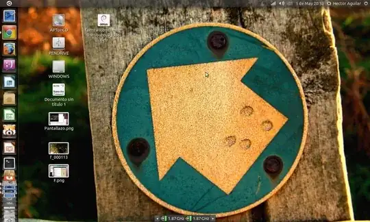

This is a picture of my desktop! on the bottom the Cpu Applets
