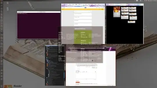

Press Super+W to see window previews from the current workspace and Super+Shift+W to see those from all workspaces. You can close each window just by a middle click on it.
Example screenshot showing visual list of open windows in Unity by shortcut pressing Super-W)
(Hold down Super by itself for a list of shortcuts that can help sort windows.)

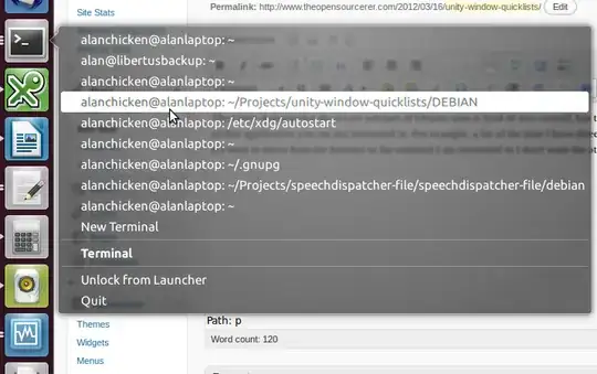

There is also,
Unity Window Quicklists
Unity Window Quicklists displays a list of open windows as quicklists for each application on the Unity launcher, and you can use them to switch between those windows. The quicklists are dynamic, meaning that when a window is closed or a new window is open, the quicklists are instantly updated.
More info http://www.webupd8.org/2012/06/unity-window-quicklists-switch-between.html
Download it https://launchpad.net/~alanbell/+archive/unity
