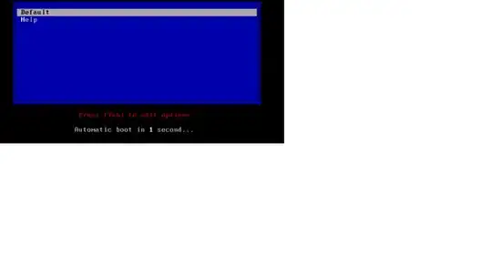

cannot install windows7 (dual boot) after installing ubuntu12.04. I want to install windows7 currently i have ubuntu12.04. I want to dual boot unetbootin does not work. I have ubnutu12.04 currently installed please tell me the steps to install windows along side enter image description here
this is what happens and it does not boot automatically even after timeout
