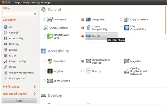

  1. Install CompizConfig SettingsManager
    sudo apt-get install compizconfig-settings-manager

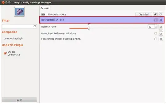

  2. Click on the Composite tab, and un-check Detect refresh rate.

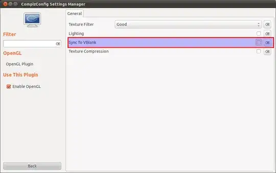

  3. Click on the OpenGL tab, and un-check Sync to Vblank.
    enter image description hereenter image description here
