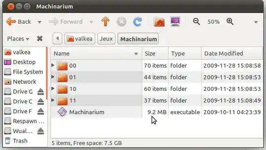

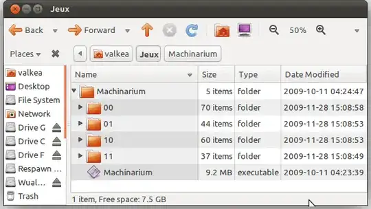

But yesterday as I was working on a program of mine, I had the exactly same behaviour. So I searched a bit and I discovered that when using Nautilus with the "List view", I was able to run the program (ie: the program does find the sound, images etc resources) when I was literally "inside" the executable folder, but unable when I was in a parent folder and expanding it to the executable folder to run it.
To illustrate the behaviour here are two screen shots.
  • It doesn't works if the executable is double clicked from here It doesn't works if the executable is started from here
  • It does works if the executable is double clicked from here It does works if the executable is started from here
This is indeed the same "place", but the Nautilus view is slightly different as the current folder is not the same and it seems to make a difference for the program.
