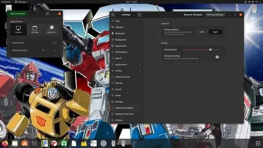

I am running ubuntu 21.04 and changing the mouse speed is eeeeeazyyyy. This is not 12.10, but this is how you do it on 21.04 it will probably work on 12.10 if 12.10 is the same way. Here's how.
Click on the applications icon in the bottom left corner of the screen.
Search for Settings.
Click on Settings and go to Mouse & Touchpad.
There, it will have a Mouse Speed slider; slide it up like so.
That should do the trick if your gui is the same or similar.
