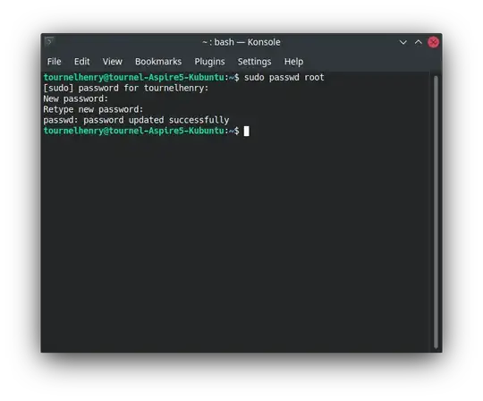

Using command, sudo passwd root to set a new root password. It's advisable to set a root password that's different from your user password and hard to guess for obvious reasons.
Preview of me setting a root user password:
preview of me setting a root user password

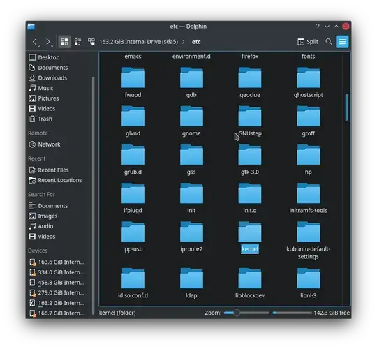

Now here's the major difference in Kubuntu. The directory /etc/kde4/ or any /etc/kde.../ does not exist in Kubuntu. /etc/pam.d/ exists, but the file you'll be editing is named sddm, not gdm-password
There's no such thing as /etc/kde/... :
No such thing as /etc/kde/...

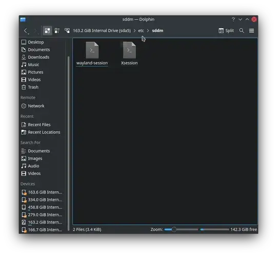

You'll be editing one or both of the files under /etc/sddm/. Their contents are the same and so is the edit.
Preview of the contents in /etc/sddm/ directory:
  • The file ./wayland-session (To enable root login if you're logging in with Wayland session in the Desktop Environment)
  • The file ./Xsession (To enable root login if you're logging in with Xsession in the Desktop environment. This is usually the default when you install Kubuntu and most likely what you're using).
  • Or you can edit both files.

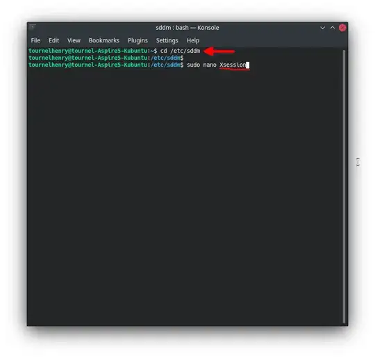

Using the Terminal/console, navigate to /etc/sddm/ and open one of the files (I'll be using Xsession) by running sudo nano Xsession (Alternatively, you can just run sudo nano /etc/sddm/Xsession from any terminal screen).

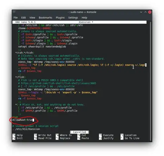

The file opens. Using the arrow keys, carefully navigate to near the end of the text context (like the last 3 or 4 lines) just under;
esac
Add the following text as one line and save the file/changes (using ^X [i.e. CtrlX] and saying 'Yes/Y').
AllowRoot=true
Preview of the file ./Xsession after editing:
The steps are the same if you chose to edit the file ./wayland-session instead.

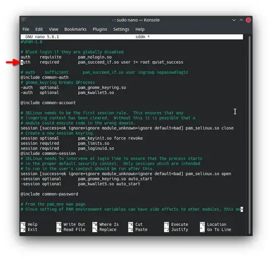

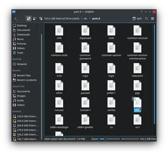

The last step is to navigate to directory /etc/pam.d/ in the Tterminal and opening the file ./sddm using the command: sudo nano sddm
(Or just run command the single command sudo nano /etc/pam.d/sddm)
Preview of contents in the directory /etc/pam.d/ showing ./sddm:

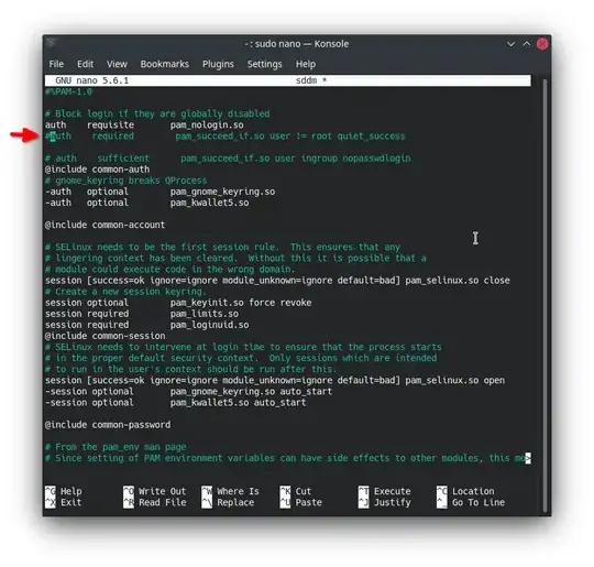

In the opened file (./sddm), near the top (like the first 3 lines or so) we'll add the "#" symbol in front of the line:
auth    required        pam_succeed_if.so user != root quiet_success
This turns it into a comment so the computer ignores that line, so it becomes:
#auth    required        pam_succeed_if.so user != root quiet_success
Again close/save the file (with ^X/CtrlX).
file ./sddm before edit:

file ./sddm after edit:
