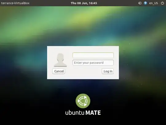

Then when you reboot you should see the following login allowing you to type in the username you want:

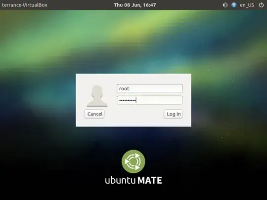

Type in root and the password you set:

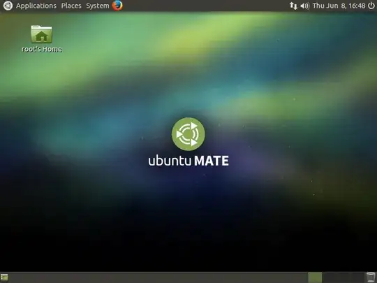

You should be logged in as root now:
