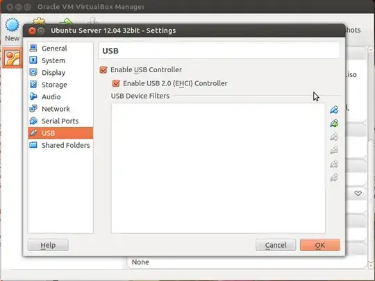

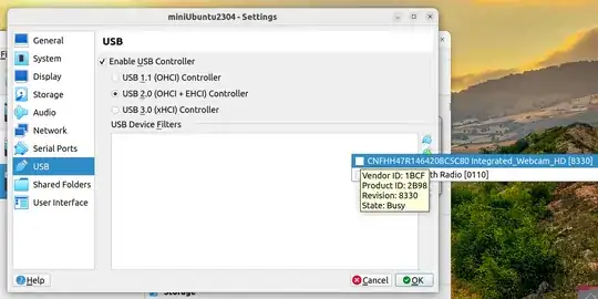

Start the VirtualBox Manager. Select one of the virtual machine of choice from the side panel. Then select from menubar: Machine -> Settings (Ctrl+S). Then in the dialog box select USB, then check on Enable USB Controller. Then based on whether your Webcam is a USB 2 or USB 3 device, select USB 2.0 or USB 3.0 radio button. Next, go to the Add USB device filters and add and checkmark the Webcam filter for your device.
addition of device filter
select USB 3.0 controller

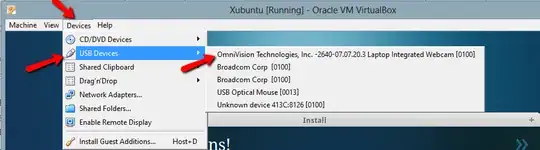

Try this. Once in VirtualBox, click on Devices --> USB Devices --> click on your desired USB device. Do you see the desired device?
