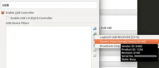

I have attached usb to VirtualBox as shown in the screenshot.
https://i.sstatic.net/UPZZo.png
But it is not possible to boot from an USB drive even when attached (reference).
So I would like to know if there is any other possiblity to boot from an USB drive?

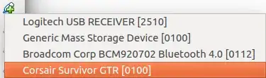

  4. Add a filter for the USB device:
  5. Boot the VM and select the "USB" option in the menu:
If all went well, the machine should now boot from the USB device.

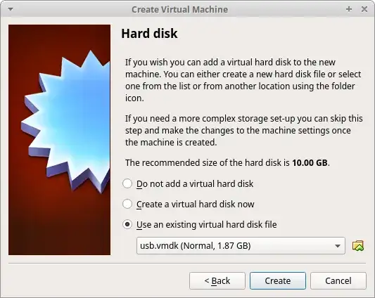

Then all you should have to do is to add the .vmdk file to your VirtualBox Virtual Machine and make sure that you can boot to it.

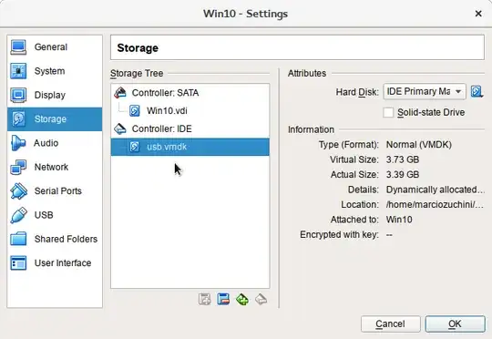

  5. Now, you just have to attach the usb.vmdk disk to a Virtual Machine. But it must be attached to an IDE controller. I tried SATA with no success.
A VM example with a bootable <code>usb.vmdk</code> attached to an IDE controller
At this point, you're OK.
Just boot the new VM, press F12 and choose the bootable drive.
Enjoy!
