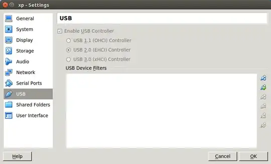

I'm using VirtualBox 5.0.20, and I have a problem with reading USB devices on XP system.
When I click right and selected "add filter from devices" I show

You need to do two things:
  1. Add your username to the vboxusers group. One way to do this is by executing sudo gpasswd -a your_username vboxusers.
  2. Download and install the VirtualBox 5.0.20 Oracle VM VirtualBox Extension Pack from here. This will enable full USB support for your vm's. Double-click on the pack and virtualbox will start and install it.
