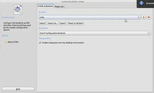

  • Install ccsm (Compiz Config Settings Manager).
    sudo apt-get install compizconfig-settings-manager
  • Log into the recovery console,
  • Launch ccsm from the terminal, (you may also optionally run metacity).
  • Create a new profile (if you want to use this method) by going to preferences, and clicking on reset to defaults:
  • You can also select the individual plugin causing the problems and reset its values.
