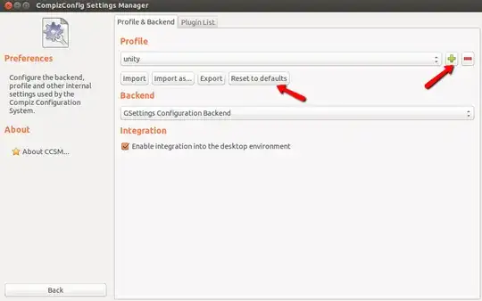

Also you can try this: Run Compiz, and and click on reset to defaults. If that doesn't help, create a new profile, and then click on reset to defaults
