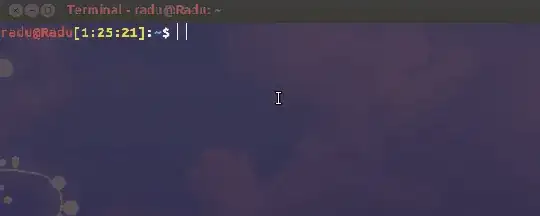

  4. In your terminal, when you are still using zsh, run source ~/.zshrc, or simply zsh, to reset your prompt. Now your prompt should look like:
    saurav@saurav-P4I45Gx-PE[1:25:21]:~$
    with some colors.
  5. If you like it, run chsh -s /bin/zsh to change your current shell to /bin/zsh (a re-login is required for this change to take effect).
  6. Run exit if you want to exit from zsh shell.
Here is a 15 second screencast from my terminal:

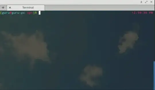

If you want to display running time in your terminal you can use this command. It will display time in the upper right side of your terminal.
  while sleep 1;do tput sc;tput cup 0 $(($(tput cols)-11));echo -e "\e[31m`date +%r`\e[39m";tput rc;done &
But note that displaying time using this command sometime may overlap the text present in terminal. So use this command with little caution.

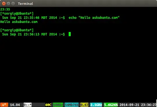

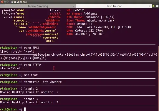

This question has been bothering me for a few days, and here's my edited post with all the material I've learned. Specifically , my goal was to achieve showing clock next to prompt in BASH. Just like Radu Radeanu mentioned in his answer, the key is to find a function or variable what is able to constantly refresh the command prompt or redraw the screen, without interfering with your screen or with whatever you type. While, this is possible to achieve with while loop, as shown by G_P, the constant redrawing of the screen with tput function messes up with whatever text is on my screen at the instant it refreshes. I've come pretty close to achieving what the OP asked by modifying somewhat the code G_P posted , but still I believe Radu's answer is the closest to what OP wants. Without further ado, here's some of the things I've learned, presented for your judgement.
#1, My preferred solution: Terminal Multiplexer
Terminal multiplexer is a software that allows splitting the terminal screen into two or more screens. In particular, I want to draw attention to Byobu terminal. This ncurses based terminal emulator, allows you to show time, CPU percentage, memory, and whole bunch of other indicators. In the screenshot from my byobu terminal you can see cpu temperature, battery percentage, internet connection quality, CPU frequency, RAM, date, and of course time. If you're mostly concerned with constantly monitoring these things while in terminal, Byobu is the way to go. In fact , I've come to like it so much, I've set it to automatically load while login into tty. The only quirk is that in tty you can't actually merge the separate windows - only switch between tabs with F3 and F4 keys.
Screenshot of my byobu terminal
An alternate solution involving multiplexing windows is by using splitvt, which splits the screen into two parts. You can run a terminal clock such as tty-clock , use watch command with date, or you can code one yourself with a script. More on that later. In the screenshot you can see one part of the split with normal bash prompt on top, and in the lower one you can see a script running, that just constantly refreshes output of date command with clear command.
#2 , While Do Loop and tput This is probably the closent to what the person who asked the question wanted implemented with bash.
G_P has posted a great solution involving the while do and tput commands. However in G_P's code there were two things I didn't like. One, the clock was to the right of the prompt, and two - because sleep cycle is 1 second (refer to the original code where it says sleep), the screen is redrawn every second, and that messes up my output. What I did, is to edit my bash prompt to be one line lower with \n operator and change G_P's code so that tput operator would position the clock right above the prompt, and refresh every 60 seconds; that allows me to see hours and minutes (and I don't exactly care about minutes), while the clock's loop doesn't mess up my screen. First, here's my prompt:
PS1='${debian_chroot:+($debian_chroot)}\n[*\u@Ubuntu*]\n $(date) :\w\$  '
And here's G_P's modified code: enter code here

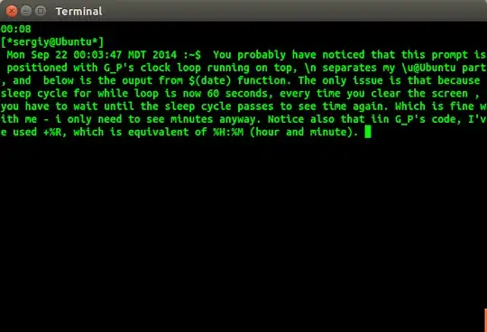

 while sleep 60;do tput sc;tput cup 0 0;date +%R;tput rc;done &
Small edit: I've noticed that this code above doesn't bring up the clock right away sometimes. Here's a better version: while true; do tput sc;tput cup 0 0;date +%R;tput rc; sleep 60; done & This one places clock on screen first, then lets bash know to go through sleep cycle of 60 second
Note, the tput cup 0 0 places clock into upper right corner of the screen, right above my prompt and sleep 60 changes sleep cycle to 60 seconds, because that way I can monitor only hours and minutes instead of every second. This way, whatever text i have on the screen isn't affected, for the most part (only when i happen to run a command the same time clock refreshes).
PS1 line is already in your .bashrc profile, so you just need to tweak it a little. The while do loop should be added somewhere in the same file, preferably in the end with # comment that this is stuff you added initially. And don't forget to always back up any file like that just in case you make bubu and need to go back to the way it was.

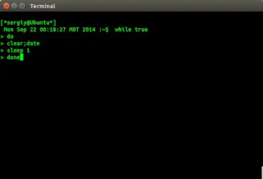

So as we already have seen the while do loop is pretty useful. Here's how you can create a clock with while do loop, date, and sleep commands.
Hit return/enter, and you basically will see output of date command shown on cleared screen every second. If you don't want to type all that every time, turn all this stuff into script:
#!/bin/bash
while true
do
clear;date
sleep 1
done
Now you can run that script with splitvt in one instance of bash, while working in the other.

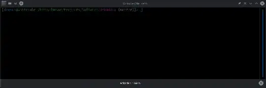

Compile and install your loadable builtin. Use it as follows:
enable -f /usr/lib/bash/reprompt reprompt
function Login::ps () { declare -gx PS1="$(your_custom_ps_generator_function)" }
export PROMPT_COMMAND="Login::ps"
trap 'Login::ps; reprompt "$PS1";' SIGWINCH
My experiments resulted: terminal resize prompt update preview
