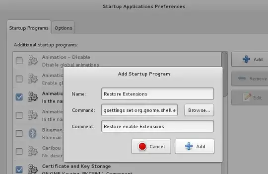

Copy the output, and then run gnome-session-properties
Press add, and then enter the output of gsettings get org.gnome.shell enabled-extensions "['use... ...blogspot.com']" - However, as has been kindly pointed out, change get to set when entering in the command box, like in the picture below. PUT THE DOUBLE QUOTES IN, OTHERWISE THIS WILL NOT WORK (If not sure, test the command in the terminal first - if no feedback is given, it worked).
EDIT: For newer versions without gnome-session-properties, you need will probably need to manually make a .desktop file in ~/.config/autostart - some GUI tools may be available via Gnome Tweak Tool or similar.
For Example:
Description 1
Then make sure that this is on:
Description 2
Now, every time you login, it should run a command to restore all the extensions!
