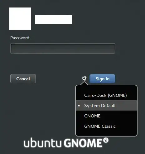

I had the exact same problem, running Ubuntu 14.10 with GNOME 3.14 from the GNOME 3 PPAs. So I tried this solution, but the real challenge for me was to find the setting to select System Default instead of GNOME on Ubuntu GNOME's login screen
Ubuntu GNOME login screen

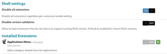

For me, all Gnome extensions where globally disabled (maybe by some shortcut?).
They can easily be re-enabled on the Gnome Extensions page.
