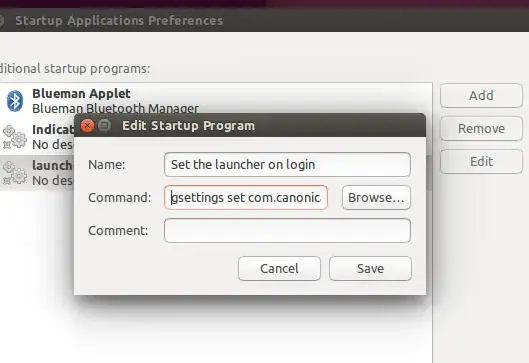

So if you get the launcher in the state you want, and use the get to get it, you can then set it back later with the set command. You could add this in gnome-session-properties and then it should set itself on login:
