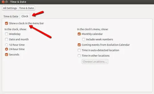

Go to Time & Date under System Settings, and after you click on it, click on the Clock tab, and make sure that there is a check mark in Show a clock in the menu bar. See image below.
