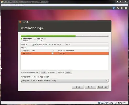

  • Click something else and then choose Continue
  • A window will open something like:
    in your case it would be different and will display two partitions sda1 and sda2 under sda. And also the free space would be at the beginning ;)
  • Select sda1 and click Delete it will free the space at the beginning.(The picture is just for help, it is at the last in the picture).

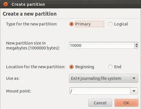

  • Then again select the free space that you've made free and click Add. A window will open something like:
    choose the exact value except the size. You have to set the size according to your need and you've to leave some size for Swap space. So I suggest you to leave 4GB for Swap. So allocate around 36 GB of size, click Ok
