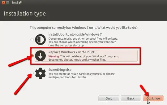

Its actually depends upon where you are installing and how are you installing.
for example enter image description here
In the above image if you choose 1st option it will install the Ubuntu and windows 7 with out any modifications to your system by choosing a safe automatic partition process with 100% success rate.
If you choose the 2nd option then your windows partition will be formatted and Ubuntu will use that partition for the installation.I mean your windows will lost.
If you choose the 3rd option then there you can specify the partition manually. so you can give a specific drive for Ubuntu installation.
usually 90% of the users will give the 3rd choice.
now choice is up to you.
