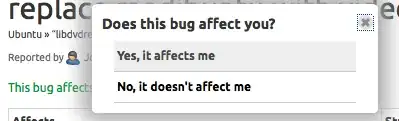

  • Test out the proposed update(using instructions below)
  • On the Bug Page, Click on the yellow icon, then "Yes, it affects me" enter image description here

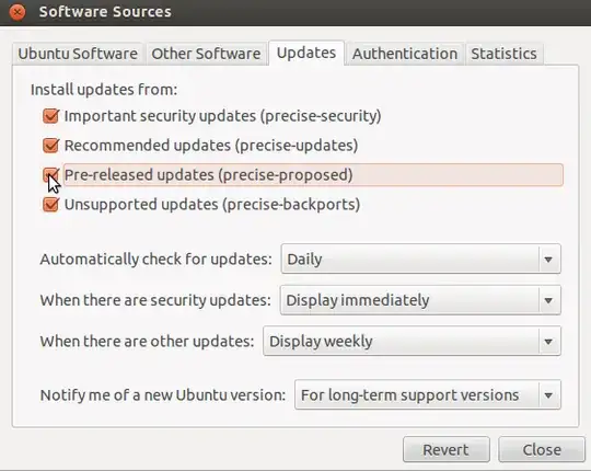

  1. Open Software Center → Edit → Software Sources... → Select the Updates tab → Check the box "Pre-released Updates(precise-proposed)" → Then click "Close"

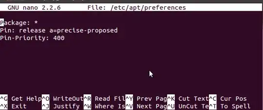

  2. In terminal run:
    sudo nano /etc/apt/preferences
    Add the text:
    Package: *
    Pin: release a=precise-proposed
    Pin-Priority: 400
    :pic After done entering text, hit Ctrl+x then hit Y then Enter to save changes.
    This will prevent unwanted upgrades of other packages in proposed and give you a shortcut to pick a single upgrade.
