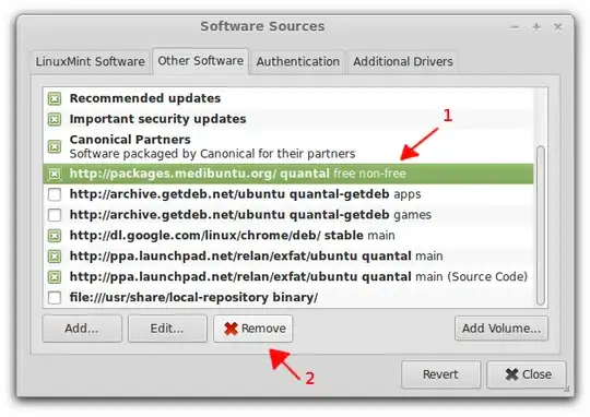

Medibuntu has now been shut down, the packagers were either obsolete, unnecessary or moved to the official Ubuntu archive.
-- https://help.ubuntu.com/community/Medibuntu
What this means? That you should remove the repositories from your sources.list to prevent errors and look for the packages you needed somewhere else or stick with the old ones that you have installed.

How to remove the repository:
  1. Open "Software Sources";
  2. Locate the Medibuntu repository;
  3. Select and remove it:
Software sources, removing Medibuntu repository
