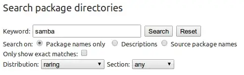

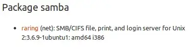

Go to packages.ubuntu.com, fill in the search form and get a nice view of the package including the version.
Hit search, then:
Additional benefits
  • Will also list versions of packages for other versions of Ubuntu. Eg. if you want to know about the version of the package in Raring (13.04), but your system still has Precise (12.04), then this will provide a way to find it out.
  • You don't even need Ubuntu to be installed.
Biggest downside is that it won't list the versions of other repositories you possible have installed, such as PPAs. You will then need the apt-cache policy approach as already posted.
