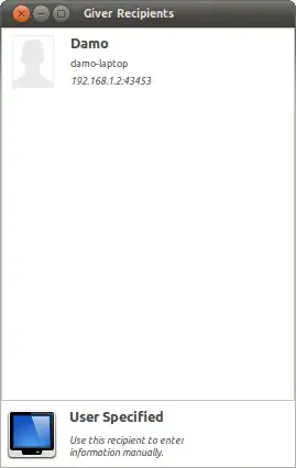

In addition to the configuration in other answers (on setting IP addresses), I'd recommend Giver as a program to transfer stuff easily between two computers.
Giver screenshot with single user
