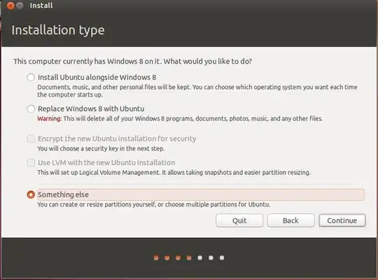

Now I am installing Ubuntu, and it's asking me whether I want to:
  • Install Ubuntu inside Windows 7
  • Replace Windows 7 with Ubuntu (No!)
  • Something else
I want the Ubuntu installation to go into the partition that I prepared for it. Should I choose "Something else"? If I do so -- will I be able to choose which OS to load at boot?
Can anyone explain how "Ubuntu inside Windows" work? it says that it will allow me to choose which OS to load at boot, which is desired.

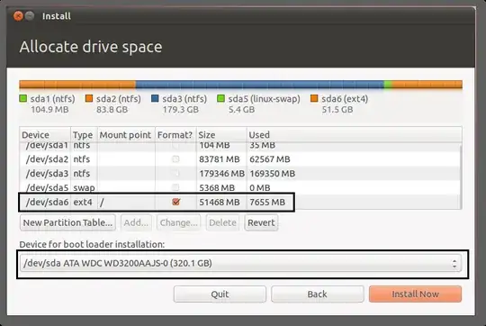

When choosing "Something else" I see also an option for Device for Boot Loader Installation:
  • /dev/sda -- the ssd disk itself
  • /dev/sda1 -- the Windows 7 loader (100MB partition)
  • /dev/sda4 -- which is one of the other partitions
Which one should I choose there?

Yes, choose "Something else" there can you choose the partition where you want Ubuntu 14.04 installed.

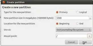

Create a new partition and leave new partition unformatted. Then reboot and insert Ubuntu 14.04 DVD (burned from iso) and choose Something else option.
instruction
Then choose unformatted partition on which you want to install Ubuntu. Create new of Ext4 file-system and mount point /

Then Ubuntu will be installed on that partition be sure boot loader is in /dev/sda
instruction
For selection swap area use any partition (split any one and create further 2GB is enough) format it as swap area.enter image description here
After installing Ubuntu you can select between Ubuntu and Windows to boot at GRUB menu.

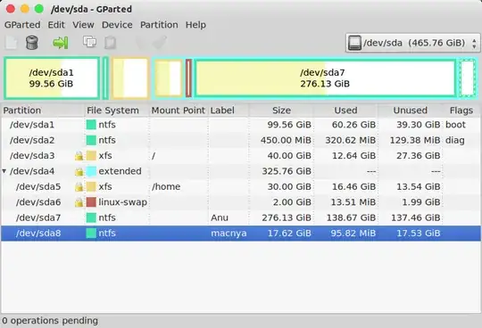

There is two ways to install the bootloader (GRUB) .
  1. In HDD itself (usually /dev/sda) This scenario is used when your HDD is formatted as MBR (Master Boot Record) partition table. Here is my old laptop partition table which is following MBR In this case, the bootloader installed in HDD itself not in partition.
  2. In separate partition called EFI. This scenario is used if your HDD is follows GPT (GUID Partition Table), depends on your firmware (BIOS/UEFI). Here is the partition looks like: The first partition (/dev/sda1) is where boot loader installed. And the last partition is 'shared' partition where i put my data and can be accessed through 3 OS.
It's seems your HDD is MBR formatted. So you can choose to install the bootloader in HDD itself (/dev/sda).

I ended up choosing "Something else" and selecting the same device to which I installed Ubuntu as the Boot Loader device.
Then I logged into Windows and installed EasyBCD and pointed it to the partition to which I installed the Boot Loader (which in my case is the same one to which I installed Ubuntu)
