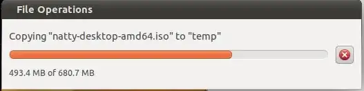

I want UltraCopier to manage the copy instead of Nautilus.
When I open Nautilus, select a file or folder Ctrl+C (or X), open another folder then Ctrl+V, I want this:
instead of this:

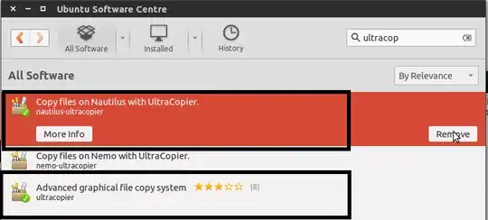

  1. Open software center and just search "ultracop", you will find two files for nautilus:
Ultracopier in ubuntu software center
  • Advanced graphical file copy system(ultracopier)
  • copy files on nautilus with ultracopier(nautilus-ultracopier)
install both of them and log out and login. Done! whenever you copy or cut you will get "Paste with UltraCopier" option in nautilus context menu
for nemo users:
install
  • copy files on Nemo with ultracopier(nemo-ultracopier)
