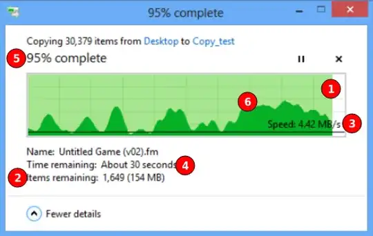

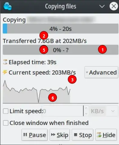

When transferring many or very large files it is annoying to just wait with very little information. I find it comforting to be able to see what is going on, even if I have to wait. That's why I would like to have something similar to what I see in Windows 10, namely:
  1. a progress bar
  2. size of file copied
  3. speed of transfer
  4. estimated time left
  5. percentage of progress
  6. a speed variation graph
I know that Dolphin has more details than others, but now I don't use KDE for the moment.
Note about the Windows 10 file manager: I have taken that as a benchmark in order to illustrate what would be the expected parameters. In fact Windows Explorer doesn't show all those parameters in all cases, e.g. while copying from an Android phone to the computer: it only shows progress and ETA. (I haven't noticed that kind of limitation in Linux.) Also, the size of file(s) copied vs total size (parameter no 2) is more limited in Windows than in Linux.

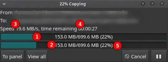

Stable, very complete and very configurable, Double Commander (meant for advanced use) also has the desired parameters:
This file manager has many other features with regard to copying, like creating different queues.
sudo apt-get install doublecmd-gtk
or
sudo apt-get install doublecmd-qt

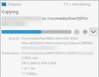

As said in the other answer, Dolphin, the Kde/Plasma default, provides many of those 6 parameters (1 to 4). Oddly, Dolphin seems to lack the "percentage of progress", but I think that in the past the Plasma notifications even showed a speed variation graph (6) on Dolphin transfer. (I am not aware of another Linux file manager that ever showed 6.)
It might be a problem having Dolphin in Gnome/GTK (it comes with many KDE- dependencies. The notifications view will be absent).

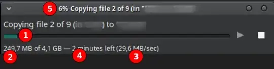

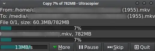

Nemo seems even more complete than Dolphin in this respect (1 to 5):
Which makes unnecessary the use of the somewhat outdated Nemo-Ultracopier
Too bad it is not possible anymore to use Ultracopier with with Nautilus, which otherwise only shows progress bar (1), speed (3) and ETA (4).

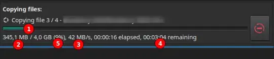

Polo file manager, although not completely developed in other aspects.
Sunflower:

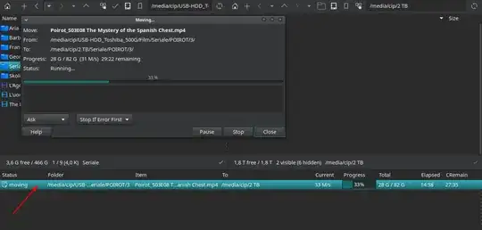

spacefm opens a status pane to display most of the desired information:
Clicking that opens a new window with more details:
spacefm is available in the universe repository for all recent Ubuntu versions. Install with
sudo apt install spacefm-gtk3    (GTK3-version) or
sudo apt install spacefm         (GTK2-Version)
