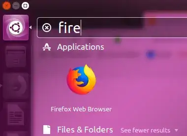

I have the default installation of GIMP which comes with Ubuntu 16.0.4 LTS (2.8.22).
I'm a fan of launching programmes by pressing Super then typing the name: Launching Firefox from the launcher
But I've tried every combination of names for starting GIMP and the application is never found. I've tried gimp, GIMP, GNU, image.
Why does GIMP not show in the launcher?
