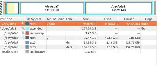

I have a hard disk of 320 GB on ubuntu 12.04 64-bit.
2 drives of my hard (sda7 and sda8 of ext3 type) cannot be mounted.
output of sudo mount /dev/sda7 /home/newfolder -t ext3 :
mount: special device /dev/sda7 does not exist
/dev/ contains the following:
 sda   sda1   sda5   sda6
but GParted shows sda7 and sda8: GParted

Did you re-partition that disk recently? That's the only thing that comes into my mind that could cause the kernel's understanding of the partition layout to differ from fdisk's.
If so, you need to tell the kernel to re-read the partition table with
sudo blockdev --rereadpt
(This used to be sfdisk -R, but sfdisk dropped -R in version 2.26.)
This can fail (with an error message) if you have any of the partitions of that disk already mounted. Unmount them and try again. Sometimes that's not possible (e.g. when your root partition is on the same disk), and you have to reboot instead.
(There is actually a way to force the kernel to re-read the partition table, which ought to be safe enough if you didn't change the sizes or positions of any of the mounted partition, but I don't remember the exact command line. I think it involves partx or kpartx.)
