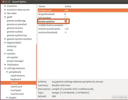

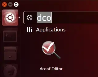

Or you can use dconf-tools to view and change the value.
2) To install dconf type:
  • sudo apt-get install dconf-tools
3) Open dconf editor and navigate to the path org.gnome.settings-daemon.peripherals.mouse. "locate-pointer" key to change the value.
