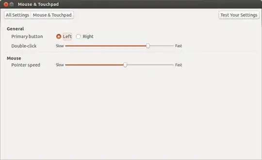

CTRL Key in VirtualBox is not working for me, that's because the "Show position of the mouse..." is hogging the CTRL key.
I don't see an option to disable this in the Mouse settings. Any idea what is going on? Any way to modify this behavior without the GUI?
Setting not available

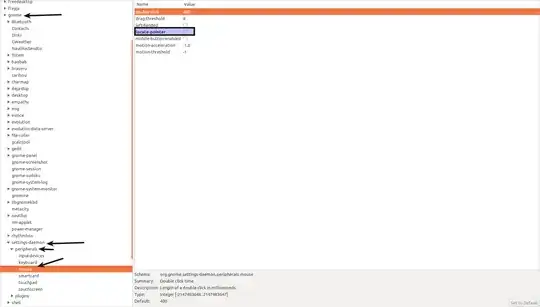

This might or might not, work.
Install Dconf editor:
sudo apt-get install dconf-tools
Open Dconf and navigate to:
org -> gnome -> settings deamon -> peripherals -> mouse
There should be a setting there titled locate-pointer.
If it's not there, then I don't think its possible to change this. Very weird it defaults to on...
Seth
  • 59,332
This feature has been removed in newer versions of Gnome (3.6 and up) so you will no longer be able to change this. If you upgraded from a previous version of Ubuntu that is probably why you have this issue.
I would suggest doing a fresh install.
