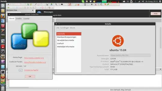

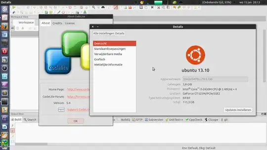

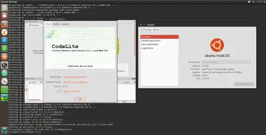

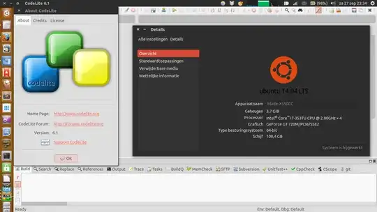

Screenshots
14.04, with latest codelite
codelite 8.1.0, Ubuntu Tursty tahr, 14.04
14.04 codelite 6.1 Ubuntu 14.04(amd64)

13.04 codelite 5.2 Ubuntu 13.04(amd64)
13.10
codelite 5.2 Ubuntu 13.10(amd64)
