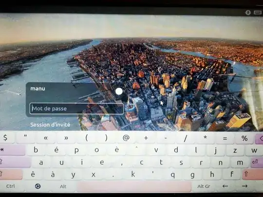

I have a netbook with an AZERTY layout. I've changed it to "bépo" to try it, but now I've reset it to a french layout.

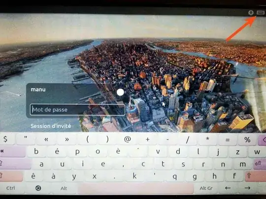

While all the apps have taken the change into account, Ubuntu's login manager still uses bépo, making entering passwords a challenge. I've enabled the virtual keyboard for the time being so that I could login again.
I don't remember what I had done in the first place to switch the login screen to bépo, but now I can't switch it back.
EDIT : In the keyboard settings page, if I click "use system defaults", then everything is in bépo ! Where is this different keyboard layout set ?

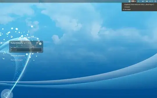

From terminal, run the following command to set the language layouts (you can set maximum four layouts) for your lightdm login screen:
gsettings set org.gnome.libgnomekbd.keyboard layouts "['us\taltgr-intl', 'fr']"
With the above command you set English (International) and French layouts, but you can change them as you wish.
To see the current layouts, you can use:
gsettings get org.gnome.libgnomekbd.keyboard layouts
Now, you should be able to use the keyboard icon from the top-right of your screen:
keyboard icon
Next is a screen capture from my login screen (I used gsettings set org.gnome.libgnomekbd.keyboard layouts "['us\taltgr-intl', 'gr', 'ro']" in terminal). As you can see, I can change the language layout as I wish:
login screen
