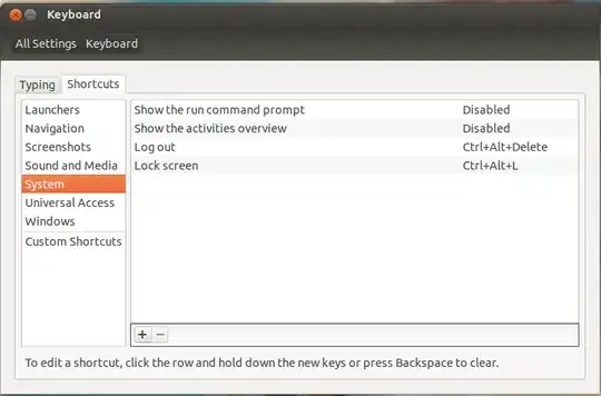

In the top panel right corner choose System Settings to select Keyboard in the Hardware section, or type "key.." in the Dash then select Keyboard:
In the Shortcuts tab all key combinations are listed. You may change them there or add your own custom shortcut. To have the poweroff shortcut back add it with a custom shortcut for the following command:

If you go into System Settings > Keyboard > Shortcuts, System,
then left-click once on 'Lock screen',
the Ctrl+Alt+L on the right changes to 'New accelerator...[something]', at which point you can hold Super [Windows key] and press L.
The keyboard shortcut will then show as 'Super+L' and works immediately.
