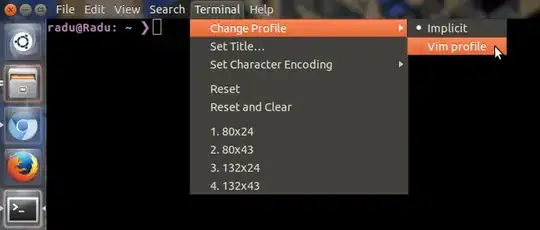

There is no shortcut that allows you to change the profile within the terminal (without navigating the menus as you said in comments), without the use of the GUI. Quoting the manual (stable, development 3.9):
You can change the profile in your current Terminal tab or window by selecting a profile from Terminal ▸ Change Profile.
(You can propose this as suggestion in the bug tracker)

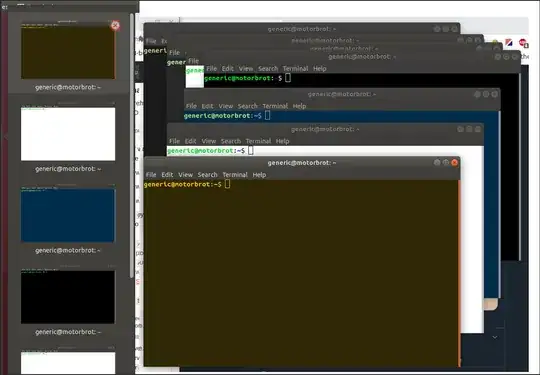

How to have a different color scheme in each new Terminal Window
The accepted answer using xdotool works, but introduces bugs. Here's a cleaner way.
First the explanation, then the code.
Explanation
  1. There is a way to create a new terminal window with the specified profile if you know the UUID.
    gnome-terminal --profile='7e95bbb3-a584-469d-8ae1-75a08287f55a'

Example Looks
I'm using some profiles from https://mayccoll.github.io/Gogh/ enter image description here
