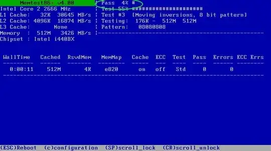

Simply boot your LiveCD, LiveDVD or LiveUSB and on the first menu you will see the option for Checking you Memory RAM (This option will not show on EFI boot enabled systems. For an explanation of this behavior please visit the MemTest86 Support Page and a Bug Report already present since 2011):
This is most likely the BEST app to check your memory. Simply wait until the first line that says PASS gets to 100% (The one that says 4% on the image below). It will repeat itself but with one pass should be enough:

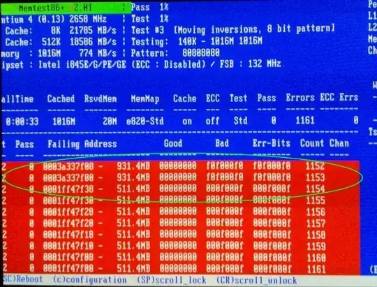

If you do have a bad memory, you will get at least one RED row on the bottom half of the app. If you get at least one, then you have some serious Memory problems. In the image below, the user has MANY memory problems and should immediately change the RAM:
I suggest to test each memory individually if you do find a memory error. This way you will know which memory slot is the culprit and can simply change that one.

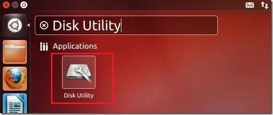

In the LiveCD, LiveDVD or LiveUSB and without any additional installation you have the Disk application. Simply open Dash and type disk, you will see the "Disk Utility" app:

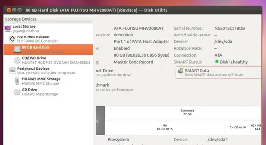

Open it and it will look something like this:

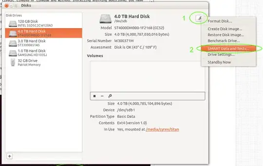

Now select your HDD or SDD and then select the Gear icons to the right. From that menu select the SMART option:
Here you can see the state of the disk, Temperature, Powered on time and any errors it has, any FAILS it has and you can even check it for problems with the Start Self-Test button below:

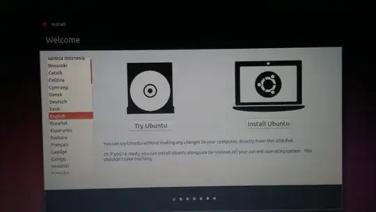

As a more recent data point complementing and partially contradicting this answer by @Luis Alvarado, I used a USB flash drive with an ISO image of Ubuntu 14.04 on a Lenovo ThinkPad T420 machine but didn't see any screen offering me the option of a memory test. Instead, my choices were "Test Ubuntu" and "Install Ubuntu" as can be shown in the screen below: enter image description here
The Ububntu USB flash drive was created with USB Creator (usb-creator-gtk from the command line).

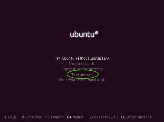

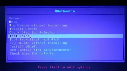

Instead, when I created a USB flash drive with an ISO image of Ubuntu 16.04 using the Unetbootin utility, I was offered the following choices:
Caveat: Upon selecting the "Test memory" option you need to press TAB and remove the initrd=/ubninit part from the boot options otherwise you get a message: "cannot load ramdisk with an old kernel image". This is apparently a workaround around a bug of Unetbootin (suggested here, here and here).
I don't think that Ubuntu 14.04 versus 16.04 had any bearing in the ability to run the memory test. Instead I believe it was simply a matter of the utility that was used to create the Ubuntu flash drive. So I think if you use the Unetbootin utility you should still get the memory test option even with modern Ubuntu releases.
update
In the comments section of this answer Luis Alvarado states that this is more of a UEFI vs. BIOS thing as opposed to USB Creator vs. Unetbootin thing. However, the fact remains that on the exact same machine the USB stick created with Unetbootin presented me with the option for a memory test whereas the USB stick created with USB Creator didn't.
