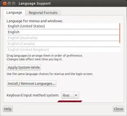

Ibus is the standard input method for Ubuntu. To enable it, use Language Support in System Settings.
Language Support options: input method

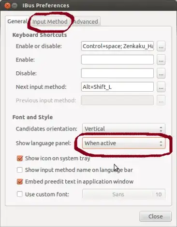

After logging out and back in, you will see the ibus indicator (a little keyboard, similar to the keyboard layouts indicator. Use the drop-down menu to open the Preferences dialog. You can also start the preferences dialog from the command line with ibus-setup.
As an aside, on the General tab, it's a good idea to change Show language panel to When active or Always. There is a bug or conflict somewhere that keeps the default option of Embedded in Menu from working. The language panel provides additional functionality for the various input methods.

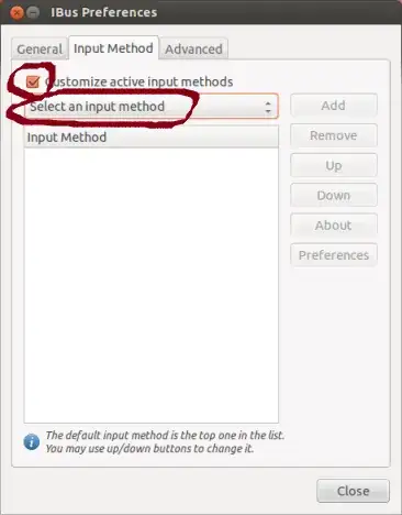

Then choose the Input Method tab. Choose Customize active input methods. Please note that installing the ibus-m17n package or language support for a language does not automatically set up an input method. You still need to do this separately.

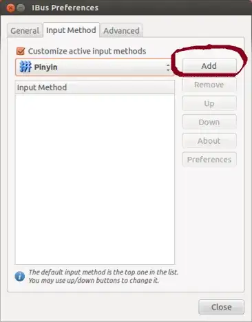

Use the Select an input method button to access the sub-menus for a long list of languages.
After choosing the one you want, the text will change to that input method. Click Add and the Close.
