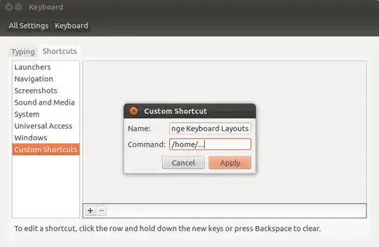

  6. Now you need to set a shortcut to call that script: press Super, type keyboard, press Enter.
  7. In the keyboard settings, go to the Shortcuts tab and on the left click on Custom Shortcuts.
  8. Click on the tiny + icon to create a new shortcut with:
    • Name: Change Keyboard Layouts
    • Command: /home/YOURUSERNAME/Documents/scripts/keyboard-layout-switch

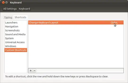

  9. Click on apply, then click on Disabled to set the desired shortcut:
  10. You now should be able to switch between two sets of four keyboard layouts with the shortcut you set.
