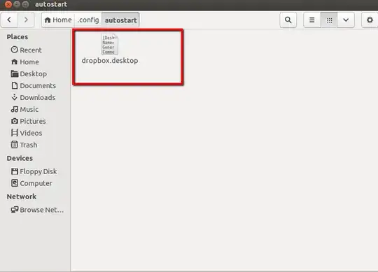

First you have to create a dropbox.desktop file, with the following contents:
[Desktop Entry]
Name=Dropbox
GenericName=File Synchronizer
Comment=Sync your files across computers and to the web
Exec=dropbox start -i
Terminal=false
Type=Application
Icon=dropbox
Categories=Network;FileTransfer;
StartupNotify=false
Once its created, you need to move it to ~/.config/autostart folder, reboot, and that's it.
Remark: if dropbox was installed from the command line, the line "Exec=dropbox start -i" doesn't work, it needs to be replaced by "Exec=/home/username/.dropbox-dist/dropboxd" where /home/username is your home directory.
