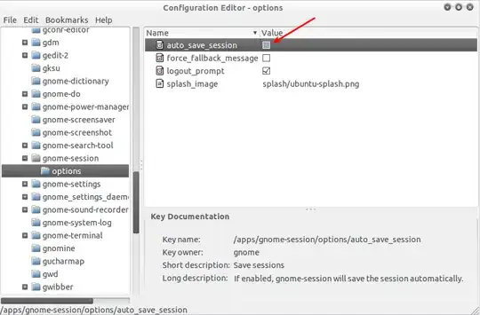

To make Ubuntu remember your running applications on shutdown:
  1. Open a terminal, and run gconf-editor.
  2. Navigate to /apps/gnome-session/options.enter image description here
  3. Enable the option: auto_save_session.
(NOTE: this may slow system boot, and has not been throughly tested.)

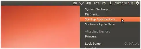

12.04 (Unity)
We can add applications to the "Startup Applications" by opening the menu entry on the top panel right side:

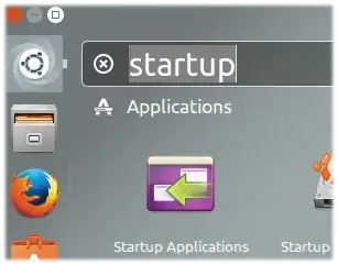

14.04 (Unity) and later
We can search the Dash for "startup applications"

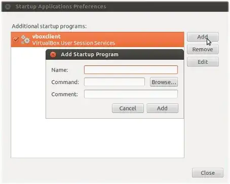

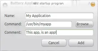

or we can run the startup preferences from a terminal with
gnome-session-properties

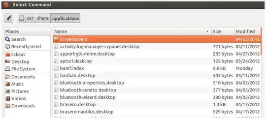

This will open a window where we can see all installed applications that will run on startup. Tick or untick the applications there or choose "Add" to add a new application:
If we know the command to run the application just enter it here in the "Command" line. We may also add an optional "Comment" here.
If we do not know the command we can choose to "Browse..." our file system for installed applications. Many default applications are found e.g. in /usr/share/application:
Select an application to add to autostart.

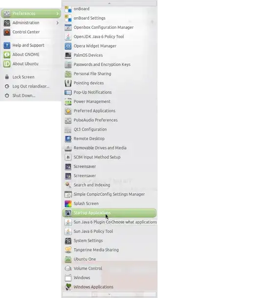

If you are using the GNOME Desktop Environment, then this is rather simple to accomplish.
  • Go to System>Preferences>Startup Applications,
menu screenshot
  • Now you can either add an application by clicking add,
  • And adding the application/script you want to run on startup,
  • Or you can add an application by dragging the launcher you wish to add from the Application menu to the Startup Applications screen.

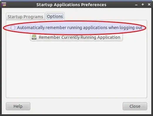

Another, possibly simpler, option would be to go to menu System/Preferences/Startup applications, then choose the "Options" tab and tick "Automatically remember running applications when logging out"
Startup Applications Preferences
This will start up any applications you have running when you log out.
