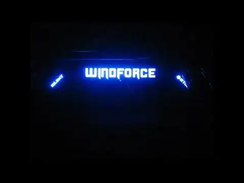

On windows its possible to turn it off with geforce-experience and it seems that it doesn't do it definitly, it does it by software on the driver...
