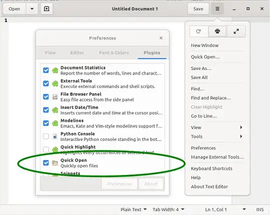

  2. Enable the plugin by clicking the hamburger menu PreferencesPlugins and enable Quick Open (see screenshot below).
    enable Quick Open

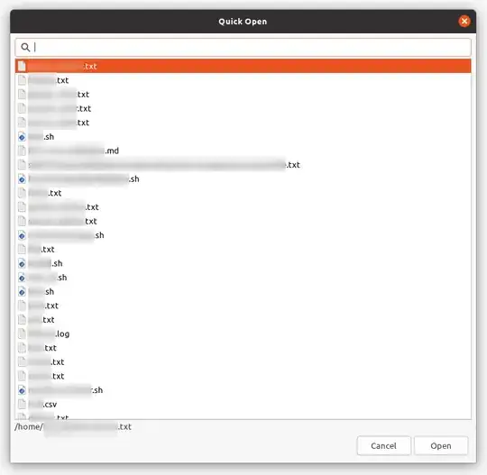

  3. After that press Ctrl+Alt+O to open a window which shows your recently opened files and also allows to search for files to open.
    Quick Open
