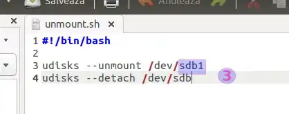

Create a new script, let say unmount.sh in /lib/udev with sudo -H gedit /lib/udev/unmount.sh and put next lines inside:
#!/bin/bash
udisks --unmount /dev/sdb1
udisks --detach /dev/sdb
Save the file, close it and make it executable with:
chmod +x /lib/udev/unmount.sh

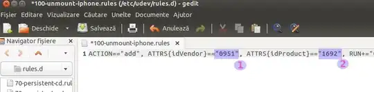

Now, you must to make a new rule file in /etc/udev/rules.d/ with sudo -H gedit /etc/udev/rules.d/100-unmount-iphone.rulesand put a new rule in there like this:
ACTION=="add", ATTRS{idVendor}=="0951", ATTRS{idProduct}=="1692", RUN+="/lib/udev/unmount.sh"

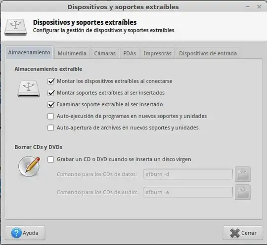

To control which programs automatically start when you plug in a device, go to
System-Settings - Details - Removable Media
Source: Ubuntu Documentation - Mount/USB
