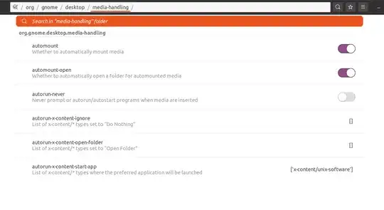

Option 1: Changing the Auto-Mount Settings
If you don't already have dconf-editor, you'll need to install it:
sudo apt install dconf-editor
From there you can type dconf-editor into the terminal and be presented with a rudimentary GUI to navigate Gnome's myriad of settings. Go to / org / gnome / desktop / media-handling / and you'll see right at the top "automount". You can toggle this off.
dconf-editor
Alternatively, you can also toggle off the option to open Nautilus when a storage device is plugged in, which may reduce the friction you feel when tethering on your phone.
Note: This is a global setting, so every device will be affected if you choose to disable auto-mounting.

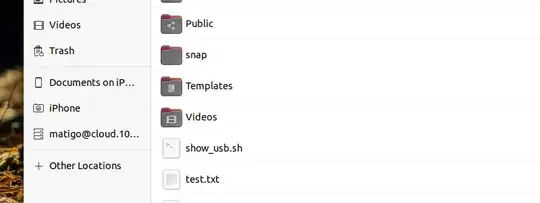

However ... this is not 100% fool proof. As mentioned earlier, Gnome seems to keep trying to mount the phone's storage devices. In my case, I can see the device(s) were ejected, but they still appear in Nautilus so long as the phone is connected to the computer:
Still Connected
There are no issues — from what I can tell — if you run all of these methods at the same time. My Lenovo Carbon is just as stable today as ever. The phone does continue to share it's network connection just fine as well, as that feature is controlled via a separate process.

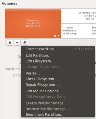

  1. /etc/fstab with noauto method
A variation from the post by Matigo, see e.g. this. The UUID can be obtained with sudo blkid, see e.g. this. And one can more easily use gnome-disks with the iPhone plugged and mounted, select the partition, and click on the cog icon Additional partition options -> Edit mount options
